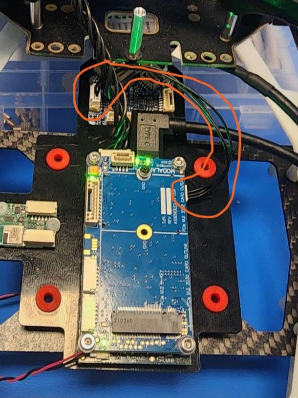

      Both FCv2 and VOXl2 are connected to the PC.

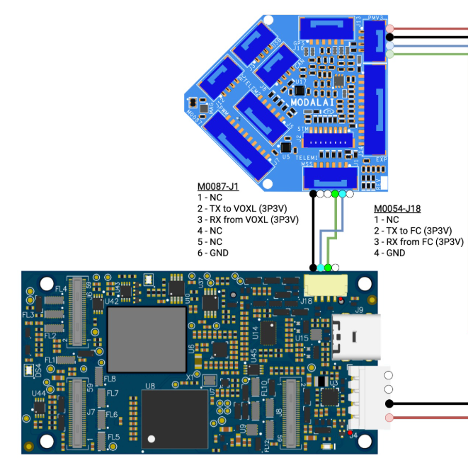

      And J1 of FCv2 and J18 of VOXL2 is connected for MAVLINK UART connection.
      ![Conenction details](b6c6849c-e75f-468c-9c1c-05be34ff146e-image.png image url)

      • Connected FCv2 TELEM1 port J1 with J18 port of VOXL2.
      • Using baudrate 57600 on both
      • Now for J18 port on VOXL2 using “autopilot_uart_bus”: 12 (SLPI_QUP2_UART/QUP2) in configuration.

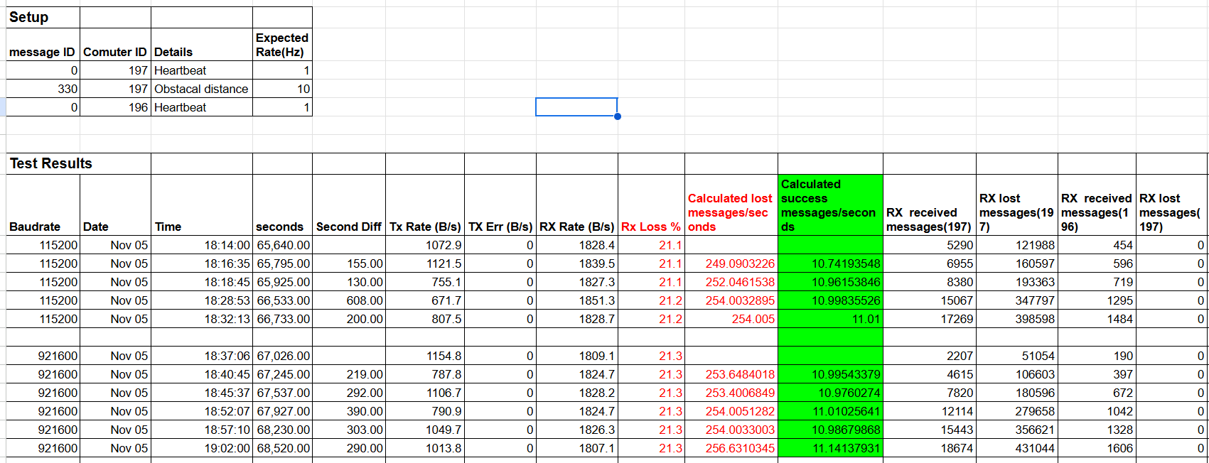

                I stopped the service and changed the baud rate, and ran app from the terminal "voxl-mavlink-server"
                Seems MAVLink connection established. and getting an AP heart rate at 0.3Hz.

                  FCv2 QGC mavlink status when communication working
                  nsh> mavlink status
                  instance #0:
                      mavlink chan: #0
                      type:        GENERIC LINK OR RADIO
                      flow control: OFF
                      rates:
                        tx: 1322.9 B/s
                        txerr: 0.0 B/s
                        tx rate mult: 0.050
                        tx rate max: 1200 B/s
                        rx: 4758.9 B/s
                        rx loss: 128.0%
                      Received Messages:
                        sysid:  1, compid:197, Total: 3287 (lost: 425347)
                          msgid:    0, Rate:  0.3 Hz, last 0.15s ago
                          msgid:  330, Rate:  7.3 Hz, last 0.18s ago
                          msgid:  331, Rate: 12.1 Hz, last 0.05s ago
                          msgid:   84, Rate: 11.6 Hz, last 0.08s ago
                        sysid:  1, compid:196, Total: 37 (lost: 0)
                          msgid:    0, Rate:  0.3 Hz, last 2.44s ago
                      FTP enabled: YES, TX enabled: YES
                      mode: Onboard
                      Forwarding: On
                      MAVLink version: 2
                      transport protocol: serial (/dev/ttyS6 @115200)
                  FCv2 QGC mavlink status when "connection to mission computer lost"
                  mavlink status
                  instance #0:
                      mavlink chan: #0
                      flow control: OFF
                      rates:
                        tx: 1621.3 B/s
                        txerr: 0.0 B/s
                        tx rate mult: 0.050
                        rx: 0.0 B/s
                        rx loss: 125.6%
                      Received Messages:
                        sysid:  1, compid:197, Total: 6025 (lost: 765633)
                        sysid:  1, compid:196, Total: 69 (lost: 0)
                      mode: Onboard
                      Forwarding: On
                      MAVLink version: 2
                  Please update if J18 is usable or not for MAVLink?
